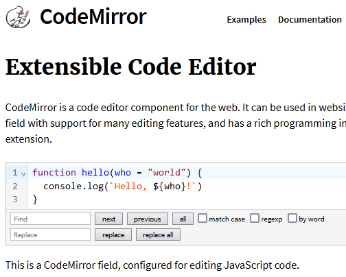

That said, has codemirror 6 been considered?  https://codemirror.net/
It has more elegant find and replace functionality:
