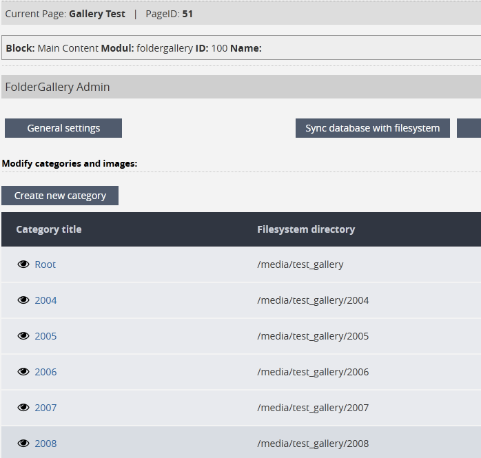

Installed latest FolderGallery 2.0.14.  Selected Root Directory.  Categories and images populated, and all can be viewed and is functioning properly in the frontend.
But, in the backend admin, when I click on any of the Category titles to edit, I get white screen.

As you are probably aware, the PHP and the WBCE version are extremely outdated. So there are probably functions in the FG which rely on newer versions of PHP and/or WBCE.
Without error messages from the logfile it's impossible to say what causes the whitescreen.

I updated the php version to 7.0, just to check, and that allows the module to work as expected, but other errors have popped up (which I expected).  So, I plan to update WBCE from 1.3.1 to the current 1.6.3.
